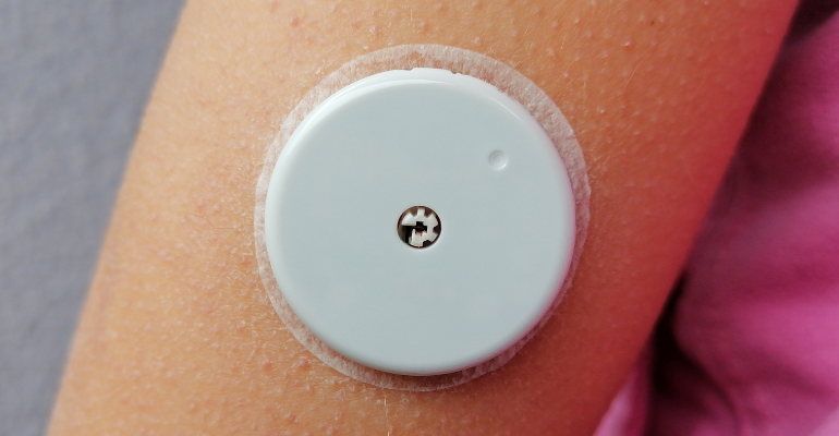

Wear time for patient monitoring and wearables continue to dominate the conversation of innovation in the space. OEMs are coming to suppliers to help lengthen the wear time of their devices through adhesive design and choice of web material, as well as having conversations about conformability and deformation resistance for flexible components.
“By far the biggest request we see is long term wear,” Steve Schroff, business development chemist at Mactac, told MD+DI. “OEMs are constantly seeking longer wear times for devices. Other requests we see are conformability and comfort related.”
