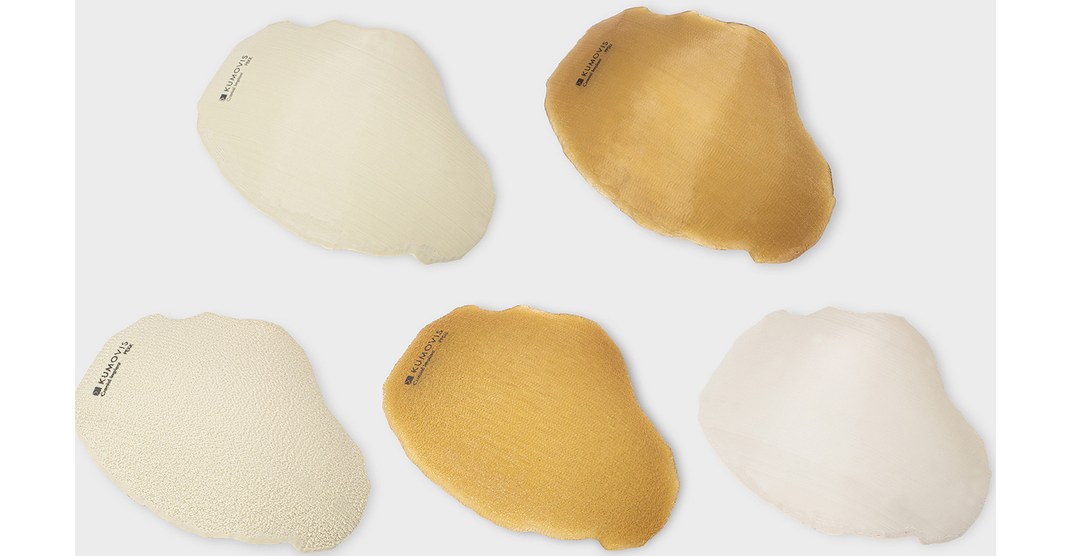

3D-printed cranial implants
Cranioplasty implants fabricated from various polymers on the Kumovis R1 printer. Top row, left to right: PEKK and PPSU (smooth surface). Bottom row, left to right: PEKK, PPSU (surface with structure), and PEEK (smooth surface). Image courtesy Kumovis GmbH.
