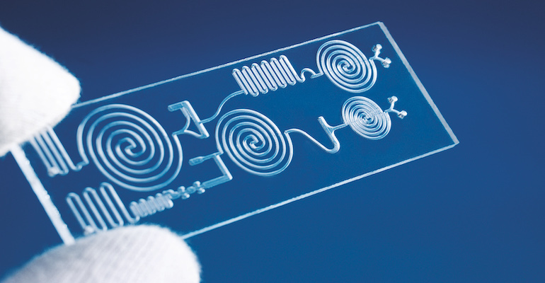

Micro-fluidic chips are designed to efficiently transport, mix, and filter  small amounts of liquids. The devices enable lab-on-chip technology, by which chemical analyses can be performed, often based on a minute amount of blood, for the early detection of disease as well as patient monitoring. A major challenge in the fabrication of the devices, noted Fraunhofer ILT, is the extremely tight encapsulation of micro-channels in the chips. “Conventional joining technology reaches its limits in the micrometer range. In its place, absorber-free laser transmission welding — with beam sources in the near-infrared range — allows high precision and flexibility, making it the ideal solution,” said Fraunhofer ILT in a press release on its website.

Micro-fluidic chips enable lab-on-chip technology, by which chemical analyses can be performed, often based on a minute amount of blood. Image courtesy Fraunhofer ILT.
