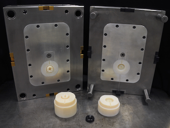

3D-printed tooling produced by Polymer Conversions for a "community project"
involving the Boy Scouts.

The company started the process last year by laying out the business model early on and creating the team that would be in charge of the program. “We talked about what we need to do to get into R&D, what tools we need, and laid out the design for the mold frame tool to hold the inserts, to get as much tool flexibility as possible.” The five members of the 3D-printing team include a toolmaker, process engineer, mold designer, quality engineer, and university engineering intern.
3D printed tooling using the FDM process from Stratasys began to look like a viable method to meet the customers’ requirements for reduced time and costs. But rather than jump into a technology the company had no expertise in, Polymer Conversions called on a local manufacturing partner, Staub Machine Co., which specializes in traditional subtractive machining (Staub Machining) and 3D printing through its division Staub Additive.
“We’ve worked with Staub before on projects, so we began working with them jointly on 3D printing of core and cavity inserts. Staub Additive’s equipment includes a Fortus 400mc FDM machine from Stratasys with a 16 x 14 x 16 in. build box; a Polyjet Connex3 machine with a 19.3 x 15.4 x 7.9 in. build box; and a desktop SLA unit, the Form1, from Formlabs.
“Through 3D tooling, we’ve been building our experience in that area, so there are many types of parts that allow us to showcase this technology to our customers,” said Harp. “This capability gives us the ability to give our customers their dream scenario, because we can 3D print the core and cavity inserts within hours, and within 48 to 72 hours, we can be in the press molding parts from that tool. The lead time to put functional parts in their hands in the actual materials—where they are comfortable with them to do functional testing—has gone from 10 to 15 weeks to 72 hours. That’s a dramatic compression for the development time line.”
