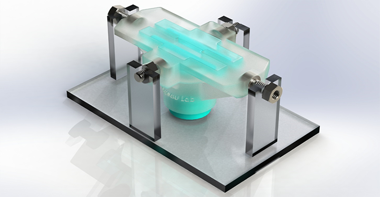

vocal-cord bioreactor
Image: McGill University/Department of Mechanical Engineering

The hydrogel’s durability was tested in a machine developed by the researchers that simulates the biomechanics of human vocal cords. Vibrating at 120 times per second for more than six million cycles, the new biomaterial remained intact whereas other standard hydrogels fractured into pieces.
hydrogel test results
Researchers designed a device that simulates the mechanical performance of vocal cords to test the new hydrogel. It remained intact under conditions that caused other hydrogels to fracture.
