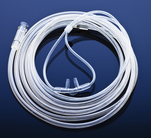

Oxygen cannulae are among the applications for the |
"PC is prone to cracking, or crazing, caused by the migration of plasticizer when it comes in contact with flexible PVC parts," Galland told PlasticsToday. The rigid PVC developed by Teknor Apex reportedly can replace PC in clear medical components such as connectors and check valves, achieving comparable strength and clarity while reducing or eliminating the stress cracking that often occurs in PC at the interface with flexible PVC components such as tubing.

Recommended applications include Y connectors, cannulae, check valves, male and female Luer fittings, suction Yankauers, filter housings, drip chambers, caps and specimen containers.
