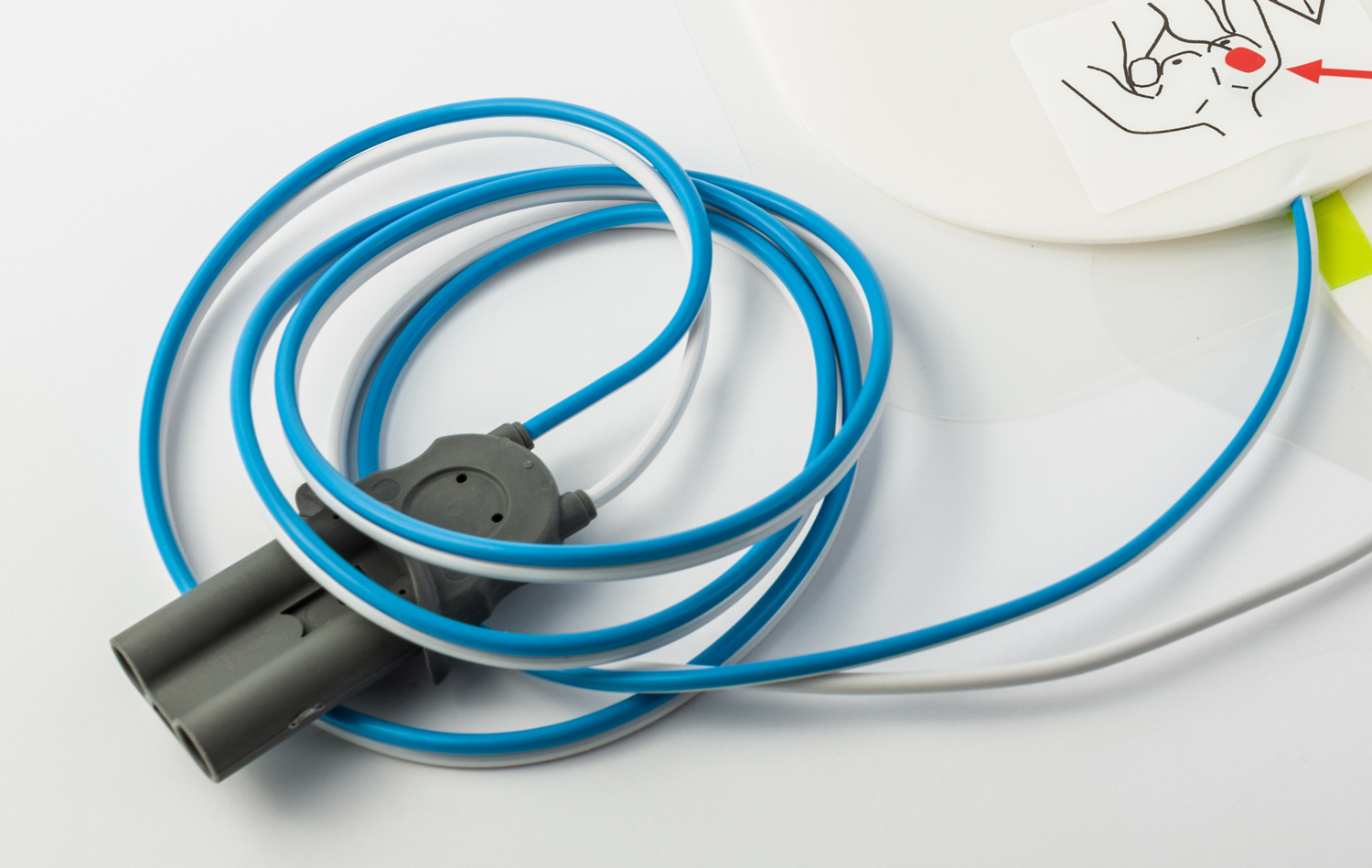

teknor-Defibrillator-Cable-Assembly-300.jpgMedalist compounds also reportedly offer enhanced electrical properties, allowing Minnesota Wire to run cables with thinner walls and facilitate coiling. "The improved electrical [properties] enable us to use these compounds in insulation as well as jacketing," adds Lewison.
Medalist MD-8421, MD-8431, and MD-8451 elastomers can be used for insulation, jacketing, and molded fittings and connectors. They have Shore A hardness levels of 92, 69, and 82, respectively; a flammability classification of HB (UL-94); and a maximum continuous operating temperature rating of 105ºC (UL-1581). They are produced in a dedicated medical elastomers facility and have passed ISO-10993-5 cytotoxicity testing, are RoHS- and REACH- compliant, and are free of animal-derived materials, phthalates, and latex proteins.
