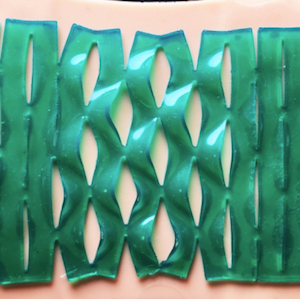

Small kirigami-like slits in a polymer film enable the material to stick to the skin, even after 100 knee bends. The same film without slits debonds after just one bending cycle. Image courtesy MIT News.
The “kirigami film” was attached to a volunteer’s knee. The researchers observed that each time she bent her knee, the film’s slits opened at the center, where the bending was most pronounced, while the slits at the edges remained closed, allowing the film to remain bonded to the skin, writes Jennifer Chu in MIT News. The kirigami structure gave the film not only stretchability, but also improved its grip: The cuts that open release tension that would otherwise cause the entire film to peel away from the skin.
