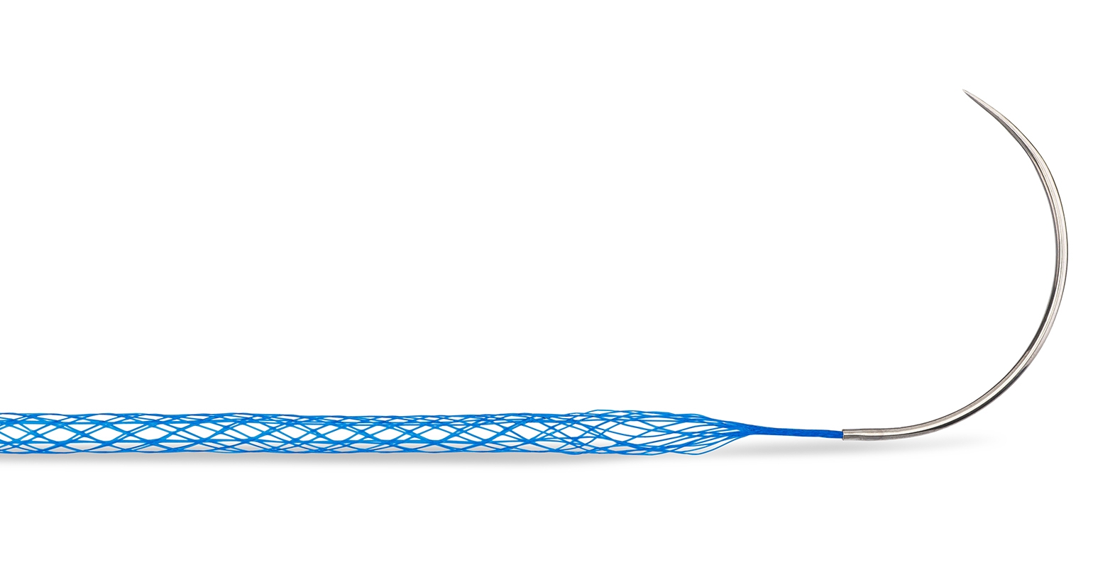

Duramesh device
Image courtesy of MSi
Mesh Suture Inc. (MSi) has received 510(k) clearance from FDA for its Duramesh non-absorbable polypropylene mesh suture. Described by the company as a first-of-its-kind product, Duramesh combines the principle of implant incorporation in a mesh repair with the placement precision of a suture for soft tissue repairs.
The device is designed to mitigate surgical failure caused by suture pull-through. The sharp leading edge of a conventional suture can slice through otherwise intact tissue, potentially leading to dehiscence (the reopening of a surgical incision), hernia formation, and poor tendon function, said MSi. The novel architecture of the Duramesh device flattens at the suture-tissue interface to prevent pull-through. Its open-walled hollow design also allows tissue ingrowth for implant incorporation. In a porcine study, Duramesh reportedly had numerically fewer loose sutures and hernias in comparison to a conventional suture.
