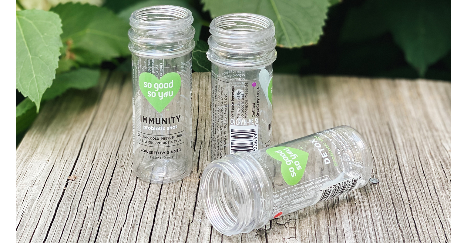

Now the Minneapolis company’s packaging breaks new ground in staking a claim with a first in beverage packaging: the sustainable PET bottles are biodegradable and recyclable.
Named “BtrBtl” (Better Bottle), the PET bottles feature a proprietary additive that “allows it to biodegrade in landfills at an accelerated rate, breaking down in years versus centuries, without leaving microplastic fragments behind.”
ASTM tests back biodegradable claims.
BtrBtl is fully recyclable, but if placed in the trash or diverted from the recycling stream, will biodegrade more than 30% after the first year in active commercial landfill conditions. The company's data is based on ASTM D5526-94 testing of accelerated biodegradation versus 2% biodegradation of untreated PET.
According to the company, BtrBtl ultimately turns into water, soil and gas that can be collected and converted into clean energy at landfill facilities.
