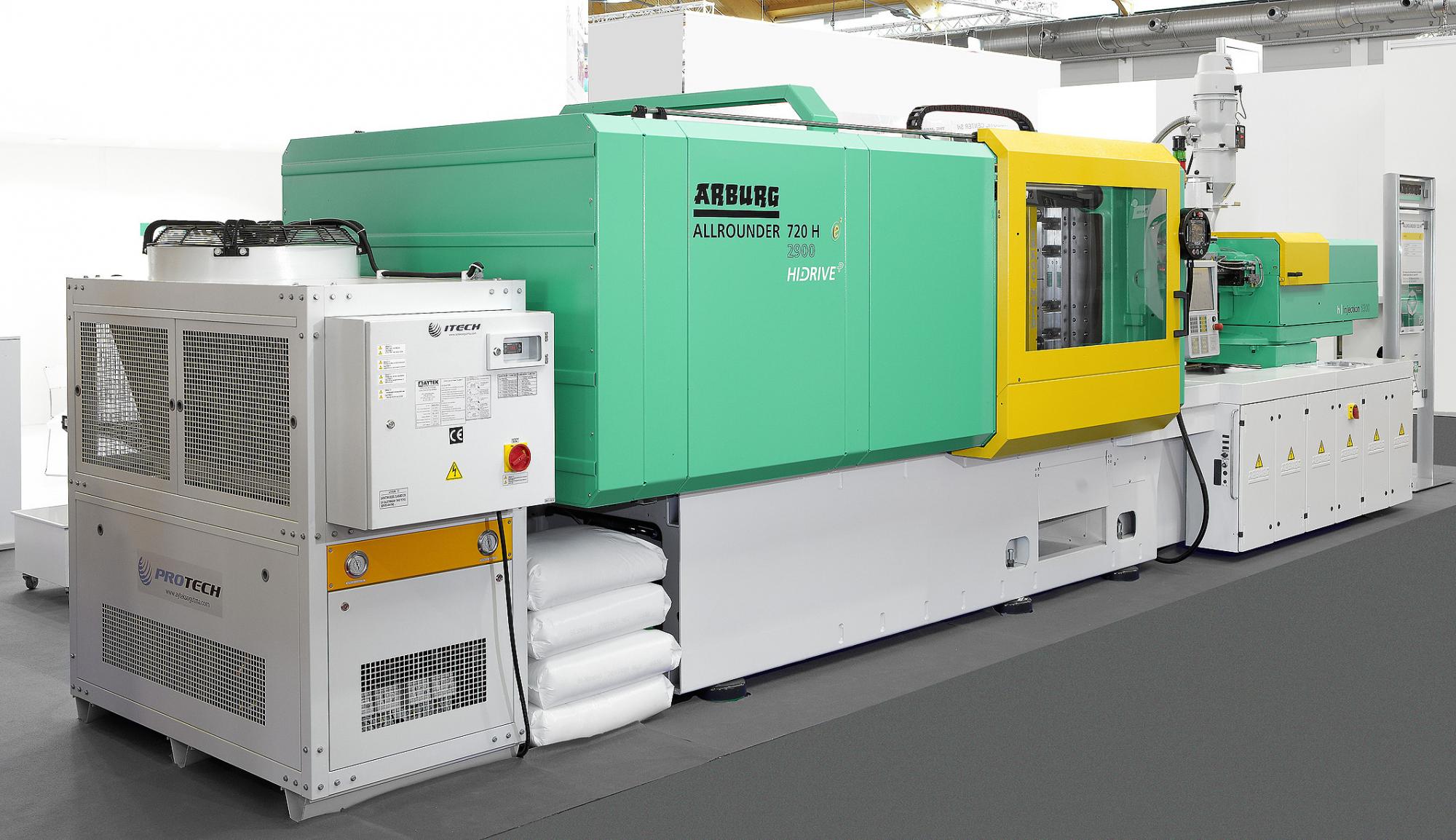

For the production of thin-walled items and screw caps, special features are available, which enable the packagingARBURG_33656-01_HIDRIVE_Packaging.jpg Allrounders to be adapted to the particular application.
The equipment for producing thin-walled items includes preparations for connecting an external in-mold labelling system or other removal system. In addition, the extension of the robotic system interface enables the robotic system to advance as the mold opens.
"Once again, the main advantage here lies in the effective reduction of the entire cycle time," the company said. "Freely programmable ramps for the hydraulic ejector ensure the fast and gentle demolding of parts. Valve clusters with large diameters help with rapid actuation of pneumatic functions in the mould, such as air blow."
In screw cap production, Arburg said that fast, reliable ejection of mass-produced parts is what counts. For this purpose, a servo-electric ejector with hydraulic booster function, in other words an increased ejection force of 250 kN, is available. The company said that this ensures problem-free demolding even in the case of shrunk-on closures.
The "ejection" and "mold opening" steps can be synchronized. The dropping of the molded parts can be adjusted to keep the mold opening times short. Higher screw circumferential speeds enable correspondingly short dosage times, which permit fast cycle times.
