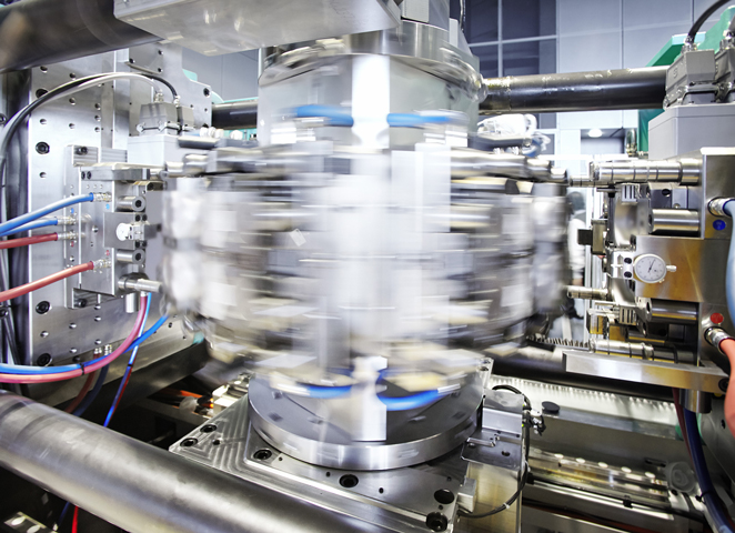

Also on show was a customer application featuring a hydraulic two-component Allrounder 920 S with a clamping force of 5,000 kN and size 3200 and 1300 injection units; the system was equipped with a cube mold from Foboha. The machine was producing two-component caps for five-gallon water bottles. A total of 32 pre-molded parts and 32 finished closures were molded in a cycle time of only around 10 seconds. The parts were demolded during the ongoing injection molding process. Each injection-molded part weighed only 10.7 grams.
The cube mold rotates during production, so that all four sides can be used allowing the mold filling, cooling phase and part demolding to be carried out simultaneously. The smaller injection unit is mounted on the moving mold mounting platen. The pre-molded parts are produced from HDPE at the first station and cooled at the second after the mold has been rotated through 90 degrees by a servo-electrically driven movement. A further 90-degree rotation brings the pre-molded parts to the third station, where the LDPE component is overmolded. The finished parts are ejected from the closed mold in the fourth station.
"This kind of machine is designed to run 24 hours a day, 7 days a week for at least 5 years," said Gaub. "The process is completely automated. We deliver a cell like this to the customer and it has to work right away—and keep working. It never stops."
