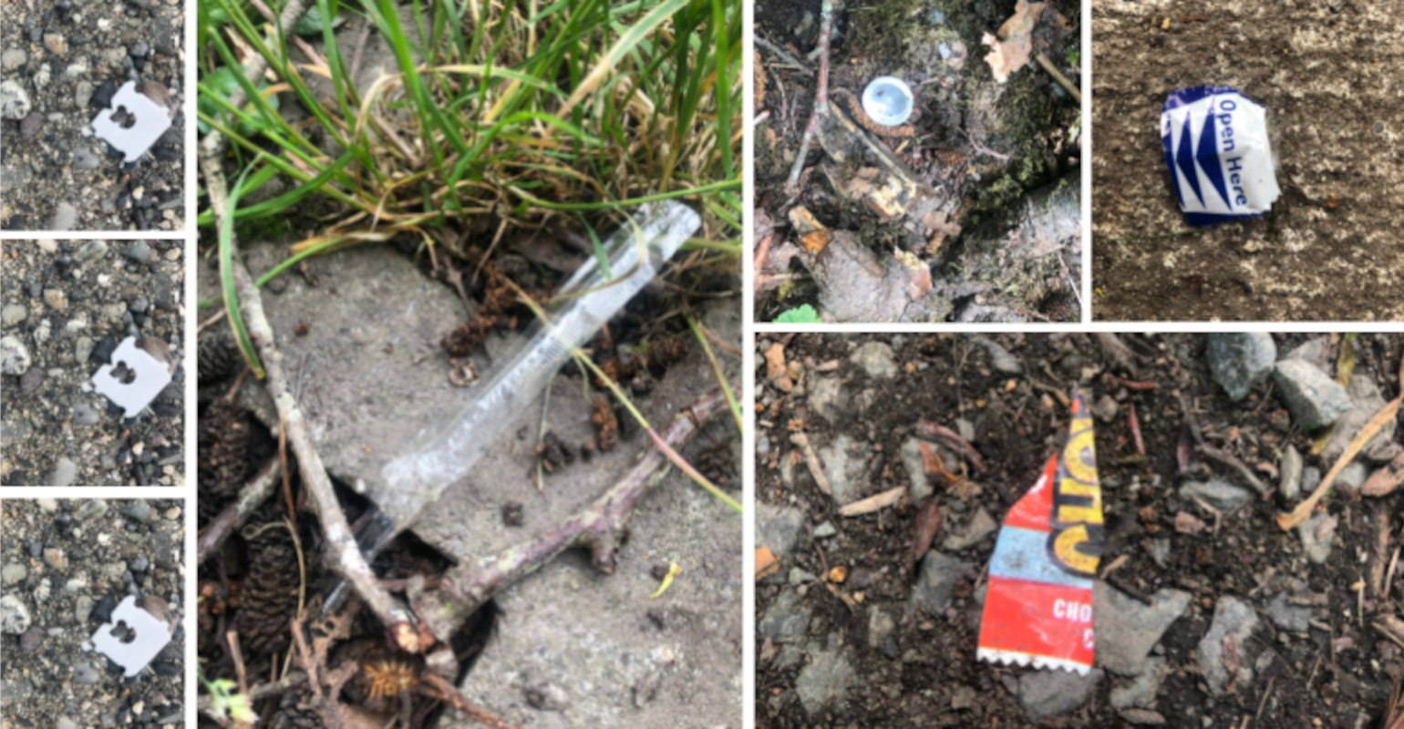

1. Does it require tearing to open?
Many on-the-go packages are multi-material flexible formats that require consumers to tear off a serrated section to access the product. Granola bars, candy wrappers, juice box straws, and snack pouches are just some of the product categories that use this type of design. The resulting “tear-off bits'' are lightweight and small making it easy for them to slip out of a pocket or bag unnoticed. Even when well-intentioned consumers correctly place the tear-off portion in a garbage bin, it may still be carried away by wind or rain.
Coastal cleanup data from the Ocean Conservancy presents these packaging types as potentially contributing to a big problem — “food wrappers (candy, chips, etc.)” were the #1 item found during beach cleanups in 2020. This litter type has risen from earlier years when food wrappers were in the top 10 but not in first place.
So what’s the solution? Companies should consider new packaging designs that do not require consumers creating small tidbits of waste. As they experiment with alternative materials like paper for wrappers, companies can also pursue innovative types of seals and closures to move away from tearable formats and “litterable” packaging types.
