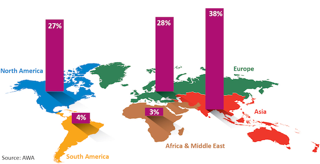

The global release liner market by region in 2016.
