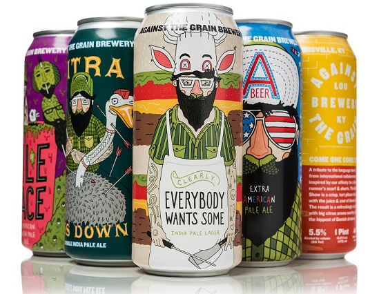

Those advantages are exactly why craft brewer Against The Grain (Louisville) collaborated with specialty plastics provider Eastman (Kingsport, TN) and Verst Packaging (Walton, KY) to create unique shrink-labeled cans. Verst’s shrink-labeled cans, made with Eastman Embrace LV copolyester (PETG), have helped ATG increase revenue, reduce lead times and double sales.
Prior to 2016, ATG used primarily printed cans, which required purchasing a full truckload (150,000 cans) for each SKU. Lead times averaged 20 weeks, and it was impossible to render graphics true to the artists’ intent, according to Sam J. Cruz, ATG co-owner and marketing visionary. Since converting from printed cans to Verst-manufactured shrink-labeled cans, ATG has launched 24 unique SKUs and cut lead times in half. ATG has better quality control and can create richer graphics with a myriad of textures that set the canned brews apart in the highly competitive craft beer market.

Matte finish for looks and grippability
The brewery relies almost exclusively on matte-finish labelstock.
“This gives a more premium look to the beer cans and helps consumers with gripping the cans,” Cruz explains. “We have also utilized the textured labels for a few labels. When used properly, they provide a unique experience in communicating a brand's intention or connection to other senses.”

In pointing to the Embrace labels flexo-printed in from 8 to 10 colors, Cruz says “the quality control and lack of limitations with our graphics makes for cans that pop on the shelf.”
That was absolutely crucial for him and for the brand.
 “We wanted our graphic scheme to align with our artist intention,” Cruz explains. “Printing on metal and doing traditional printing often leaves a lot to be desired. With the material we are using for our sleeves from Eastman and Verst, we are able to get as close as possible to our specific art intention. Colors, texture, all that matters. We stand out by not compromising on our values of providing an excellent product. The sleeves make all that possible.”
