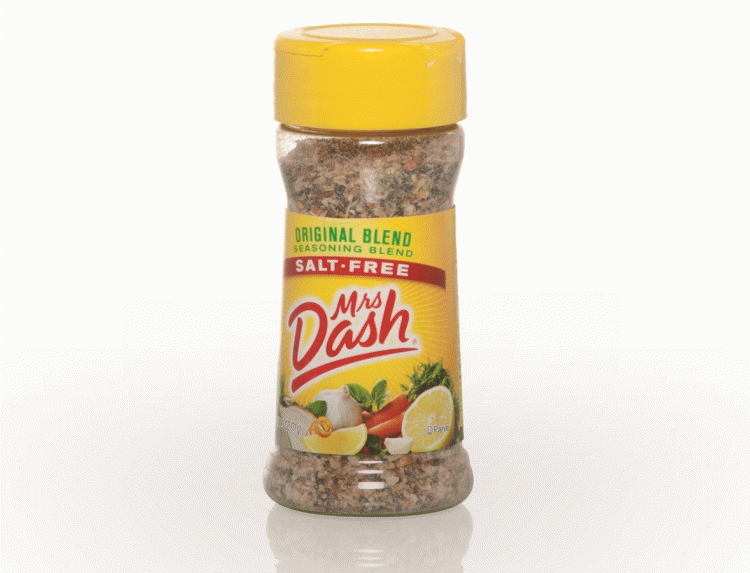

MrsDash72dpi.jpg.gifMeredith-Springfield Associates (Ludlow, MA), a plastics manufacturer specializing in extrusion blowmolding and injection stretch blow molding, pioneered the use of this new technology to manufacture this type of sustainable plastic packaging.
"We look at a package and we think outside the box - we don't take the existing package and just replicate it," Mel O'Leary, president and CEO of Meredith-Springfield, told PlasticsToday. "This package has been around 15 to 20 years and we didn't want to mess with its legacy, but we did feel that it was overweight and to drop that weight would provide a savings opportunity for the brand."
In fact, O'Leary believes that manufacturers seeking more sustainable plastic packaging should look for innovative ways to reduce PET. Meredith-Springfield constructed pilot molds and conducted design experiments with the objective to reduce the amount of PET used in the creation of Mrs. Dash packaging.
"For Mrs. Dash, we are using the most advanced plastic molding technology to alter the amount of plastic and place PET only where it most impacts package performance," he said. "In reducing the weight, we carefully engineered the placement of remaining mass of plastic to go into the areas of the bottle which would maximize top-loading ability."
