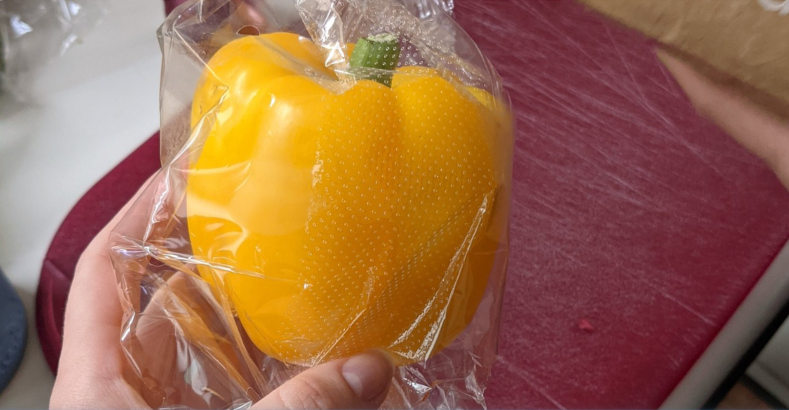

Photo credit: @samanthabayers - Twitter
A packaging professional will recognize and appreciate the pattern of holes in the plastic wrap of this yellow bell pepper. The perforations are a relatively simple form of modified atmosphere packaging, allowing the gases generated by the ripening of the pepper to escape, which slows down the inevitable product decomposition. Ta da! Shelf life is extended!
When quality matters, as is the case with ingredients in a HelloFresh meal kit, the extra days of freshness can mean a difference between a satisfied customer or a never-again ex-customer.
The packaging engineers at HelloFresh obviously know this. Good. But their customers probably don’t. And that led to this critical tweet.
