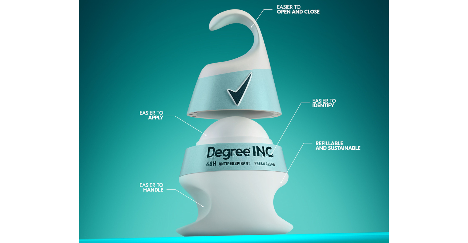

Now in trial, the Degree Inclusive liquid roll-on deodorant package is designed for people with disabilities.Photo supplied by Degree

Unique features of the prototype package are:
• A hooked design for one-hand use.
• Magnetic closures for easy cap removal and reclosing.
• Ergonomic grip for easier application for users with limited mobility or no arms.
• Braille instructions on the label for users with impaired or no vision.
• A larger roll-on applicator to reach more surface area per swipe.
