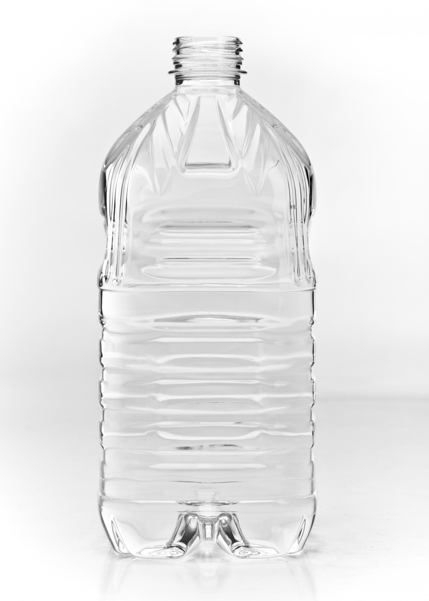

64ozlightweightbottle_MG_7360.jpgAmcor's Innovation Group developed the patent-pending Powerblock 3.0 technology to provide a lightweight and strong hot-fill stock PET bottle with advanced filling and stacking performance. The hot-fill container also features a 38-mm lightweight finish compared to the standard 43-mm finish for 64-oz PET bottles.

Multiple utility and design patents are pending for the Powerblock 3.0 container. Amcor said that one patent covers an optimized conical base pushup with special diameter and height ratios and relationships. Another patent covers a round or rectangular base with strap-like features that are added to create a footed-style base. The segmented standing surface consists of four standing 1-inch columns.
Together, these technologies work synergistically to unlock material normally trapped in the base area. This allows for better material distribution in the container body, resulting in a lighter weight container without sacrificing performance, Amcor stated. Angles, ratios and other bottle geometry are optimized to obtain a balanced response to vacuum, pressure, and top-load forces.
"It's a novel design," Hodges said. "The footed-style base allows us to distribute the material in such a way that it takes weight out of the product."
Amcor touts that the Powerblock 3.0 provides several benefits including multiple fill contact points and flat sides for added stability and an optimized footprint (width and depth) for improved pallet pattern and corrugate savings. Sustainability benefits include a reduced carbon footprint and transportation costs along with secure consumer handling with three intuitive areas for single hand pouring.
