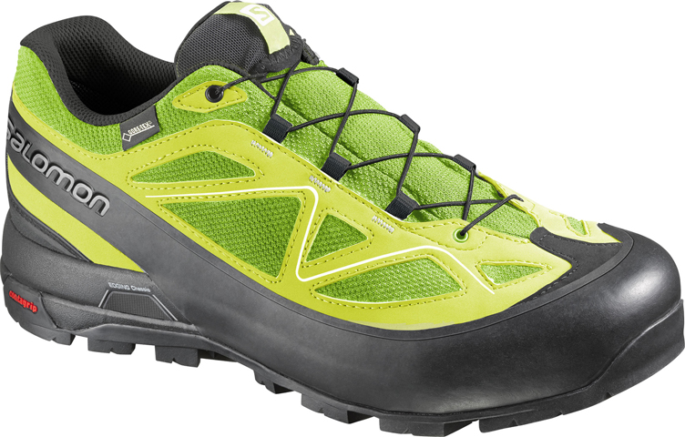

salomon-350.jpgComfortable and lightweight, Salomon's X Alp range of mountaineering shoes are designed with a so-called Edging Chassis, patented by Salomon. The feature is a special plate built into the sole with a sophisticated design that combines two opposites, flexibility and stiffness. The Edging Chassis provides stability for the foot in the transverse direction—to provide good grip on narrow ledges—but also allows enough flexibility in the longitudinal direction to accommodate the natural flexing of the foot.
