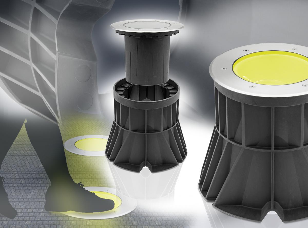

EMSIn-groundlighting1.jpegThey do so by forming a skeleton-like structure inside the finished part, thus increasing the mechanical properties of the component. In this way, stiffness and strength values can be achieved, which are significantly higher than those of thermoplastics reinforced with short fibers, without impacting on other properties, such as chemical resistance or surface quality. The long fibers also reduce creep and increase dimensional stability.
In addition, the thermal properties of these materials are markedly better at high or low temperatures. This means that components can be made which, for example, must be resistant to high thermo-mechanical loading while having excellent surface quality.

Although the mechanical properties and stiffness-to-weight ratio means that this is a technology that offers huge benefits for the automotive industry, the advantages offered by long fiber technology are not limited to vehicles alone. Architectural lighting specialist ERCO selected Grivory GVL-4H, a long-fiber reinforced design material to replace the metal that was previously used for the housing of its TESIS in-ground exterior light. The problem with the stainless steel housing was both its weight and the fact that it corroded due to contact with the ground. Moreover, it is not unusual for heavy-duty vehicles to drive over these lights, which meant the material used needed to be extremely tough. Tests on the light housings made with Grivory GVL-4H showed compressive strength of 17 tons, although only a value of 5 tons was required. As these lighting systems are very popular with ERCO's customers and the material more than met all expectations, further development projects with this material are already underway.
