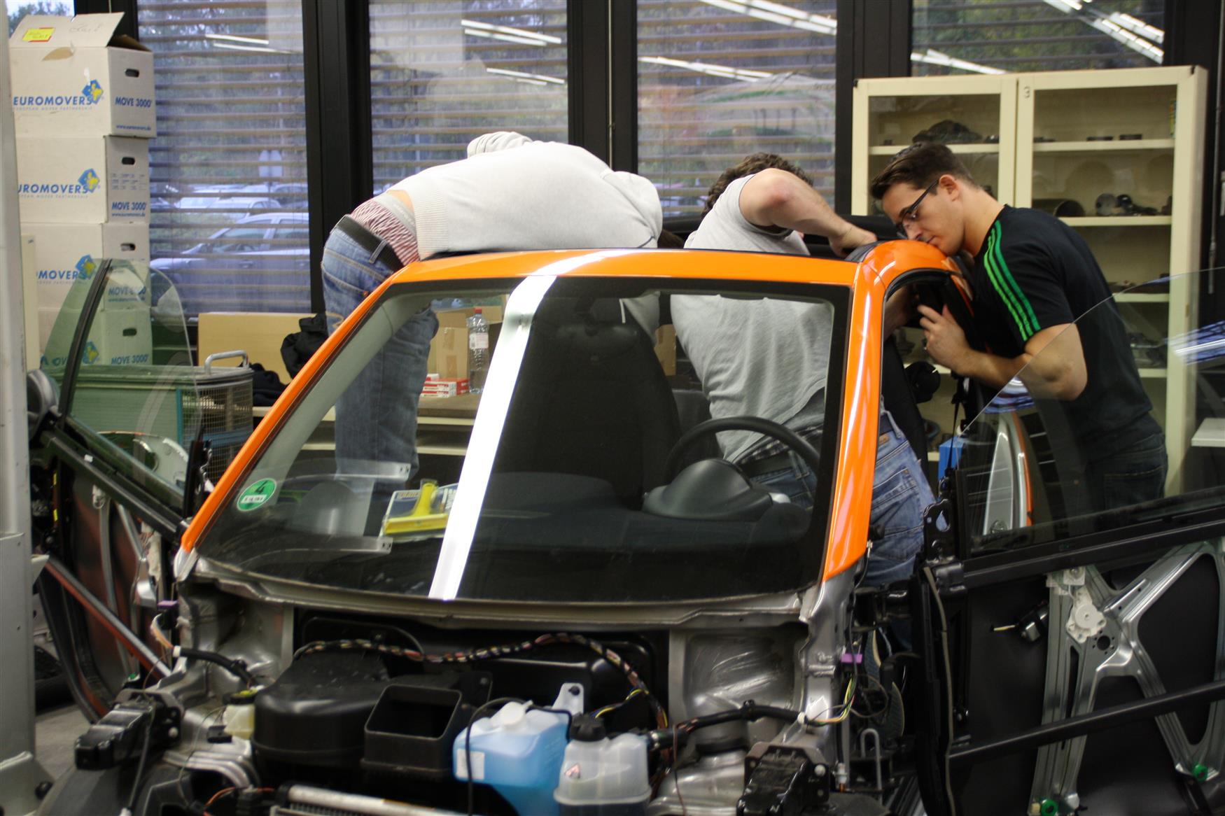

The car was retrofitted with 56 igus bearings over the month-long rebuild.
During the retrofit process, the car was completely dismantled to access all replaceable bearings.
