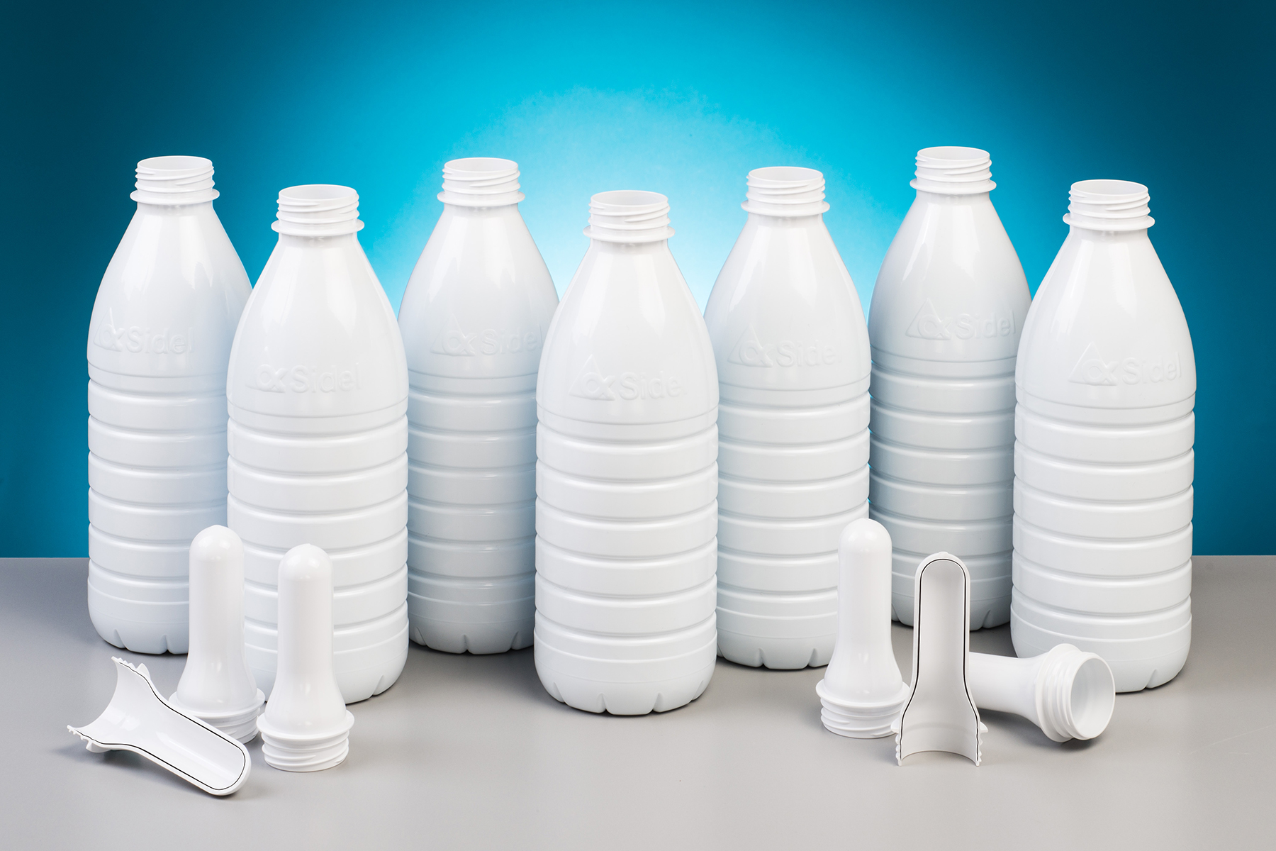

The new Kortec LB technology allows the molding of a three-layer preform, which is then blown into the milk bottle. The preforms, developed by Kortec in cooperation with Sidel, consist of three layers of PET: white on the outside, black in the middle, and white on the inside. This approach ensures that the light-blocking black PET layer covers the whole of the bottle, including the base, thereby providing no access for light.
To block the correct wavelengths of light from entering the package, barrier-layer material placement and dispersion is critical, according to Kortec. Working with Sidel, Kortec's first products with this technology are 25g preforms for 1-liter bottles. Bennett said that 22g preforms are currently in development.
