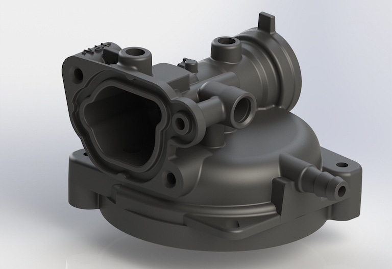

The molded carburetor |
The mold design, development and in-depth testing were absolutely critical to accomplishing the customer's goal of a plastic carburetor. Considerations had to be given to critical design factors such as wall thickness, gating, material flow patterns and ejection. To assist with the evaluation of these factors, a Moldex3D analysis was performed to validate gate placement and ejection based on the geometry of the part and the material flow. Filling the part would be challenging because of the complex geometry which also required highly complex part ejection.
Another challenge was the "bowl contouring" which was critical to this project. "The concentricity and bowl diameters have to be held in manufacturing every day or every part we manufacture," said Steve Long, manufacturing support manager, adding that the carburetor has just shy of 500 dimensions, with several dozen of those being critical dimensions that require checking with a CMM that Hoffer purchased specifically for this project.
