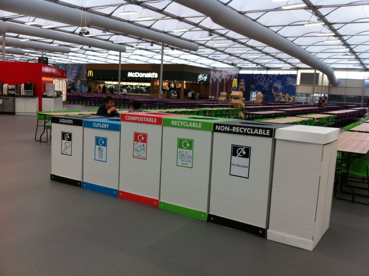

All compostable materials will be labeled with an orange recycling symbol and can be put in a corresponding orange bin, Recycle_bins.jpgalong with any food waste. Recyclable materials will have a green symbols to differentiate them from non-recyclable and compostable wastes. These materials can then be put in corresponding green bins, which will be placed around the Olympic venues.
In total, there will be about 4000 containers for recycling, composting and residual waste across Olympic venues.
