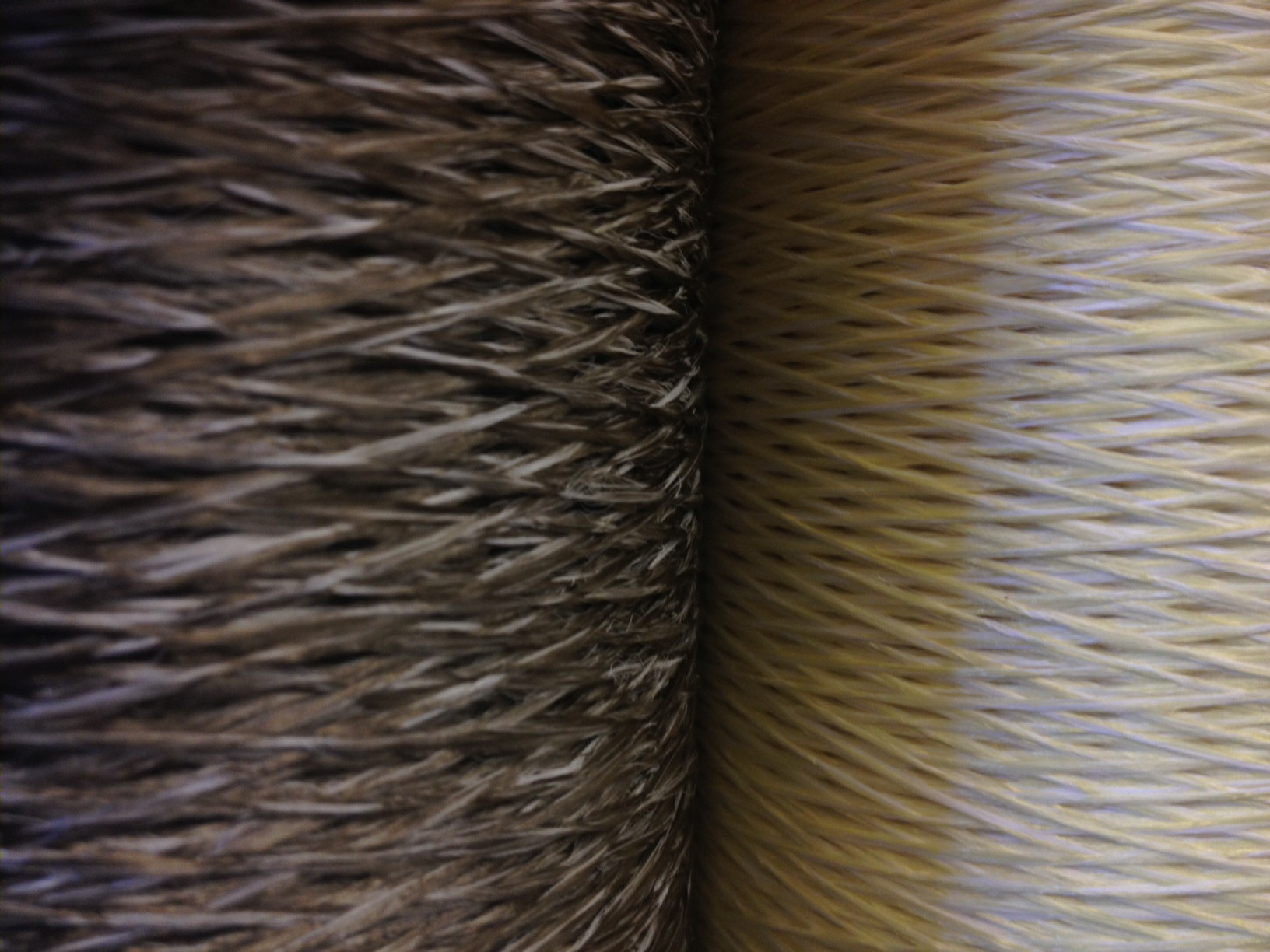

Innegra H, a high-modulus polypropylene-based yarn, is now being integrated at the filament level with carbon fiber. Innegra H costs one-third less than standard filament carbon fiber and up to two-thirds less than expensive aircraft grades, said Innegra VP Jeff Ettin in an interview with Plastics Today at JEC Americas in
Boston.
"This fits well in applications where you are looking for impact resistance and a significant weight reduction," Ettin said. OEMs are testing composites made with the new hybrid yarn in interior applications such as door panels. It's not appropriate for use in applications that require continuous thermal resistance of 300F or higher.
Ettin said that Innegra H is different from other hybrid yarns that are joined by kinking or twisting. In the process developed by Innegra Technologies (Greenville, SC), the fibers are combined without compromising their mechanical integrity, according to Ettin. In an iteration, Ettin showed Plastics Today, the yarn was about 70% carbon fiber and 30% Innegra.
