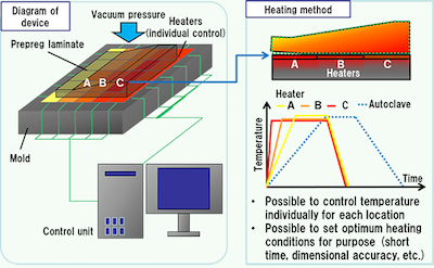

Localized heating in out-of-autoclave process reduced dimensional inconsistencies, accelerates fabrication time. |

The newly developed fabrication technology provides a solution to the problem with a number of embedded sheet heaters on the tool surface that are individually controlled. The part under vacuum is heated effectively from direct contact with the heaters, which achieve energy savings. Further, controlling individual heaters and allowing optimum heat distribution at each location provides even residual stress throughout the fabricated part. As a result, the part can be fabricated as close to the original design with minimal dimensional inconsistencies, which will reduce labor cost and duration of part assembly.
In order to effectively control this heating system, Toray carried out a joint research program with Ehime University and Tokyo University of Science to establish simulation technologies to predict part deformation and optimize heater temperature. Toray combined them into a program for designing heating conditions that would effectively minimize fabrication time and dimensional errors of the parts. Toray installed a prototype fabrication device and is currently conducting demonstration trials.
Depending on the part shape and dimension, it takes about nine hours to fabricate a large CFRP part for aircraft using conventional autoclaves and ovens. The newly developed fabrication technology, on the other hand, is expected to reduce the fabrication time to about four hours. Moreover, this technology achieves about 50% energy saving compared to conventional fabrication methods as pressure and heating media such as heated air is not required. It is also expected to save time during assembly for correctional work using shims because of the improved dimensional accuracy for fabrication.
