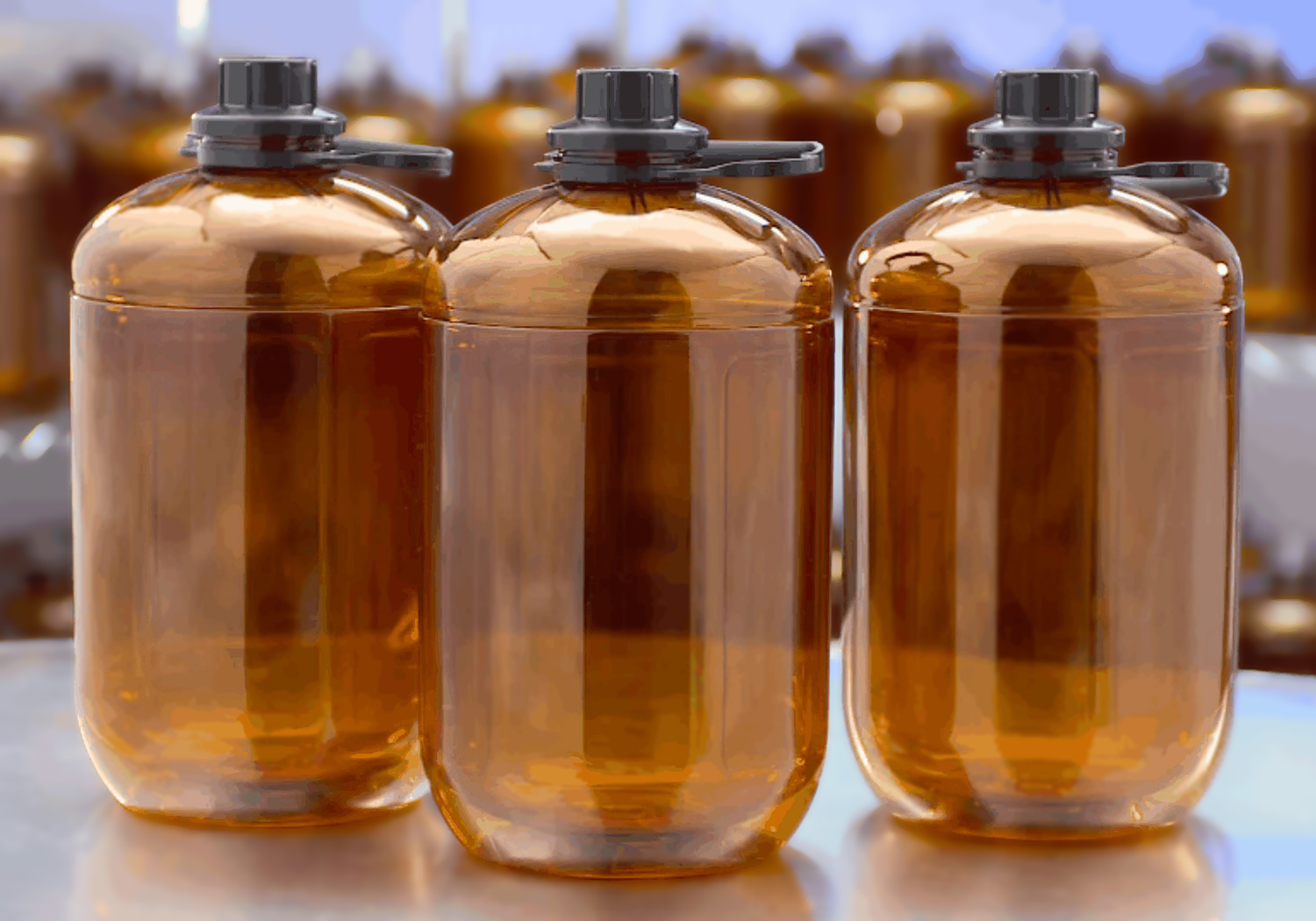

Momany's presentation at the conference featured PTI's collaboration with ATMI, a provider of packaging solutions for specialty liquid materials. The companies worked together to produce BrightPak, a liquid dispensing and delivery system for sensitive chemicals that features a collapsible rigid liner inside a bottle.

The BrightPak system's primary components are created from two separate preforms. The polyethylene terephthalate (PET) preform is used to blowmold a bottle with a capacity of 4.6 liters.
When it came to material selection, Momany said PET was selected due to its ability to withstand the dispensing pressure, plus its cost effectiveness and robustness.
The second preform is made from polyethylene naphthalate (PEN) and is used to create the rigid, three-dimensional collapsible interior "liner" which holds the chemicals. PEN was chosen also due to its compatibility with various chemicals, plus its robustness and flexibility, according to Momany.
Once the materials were selected, the next big issue was the "ship in a bottle" challenge of how to place the rigid inner PEN liner into the outer PET bottle. PTI eventually developed a proprietary solution.
The two-piece assembly fits into a third component, a blow-molded, full-body PET "base cup." Since the PET bottle has structural panels which make labeling challenging, the textured full body cup facilitates branding options and also provides a stable base for the bottle's slightly rounded bottom. The packaging's amber color provides another layer of UV and shipping protection.
The BrightPak package dispenses liquids without allowing air into the chemistry, which eliminated the sources of bubble formation and particle defects caused by pump and vacuum delivery containers.
Drive gas can be applied between the rigid liner and the bottle. Once in this space, the pressure from the gas squeezes the rigid liner causing it to collapse and force the chemical out of the bottle. The system dispenses the chemical through a sealed pathway from the liner to the dispense tool, and it protects the chemical contents from external contamination. The rigid liner eventually collapses fully and ensures optimal dispense results.
The BrightPak technology, which ATMI also refers to as a "double containment" system, offers multiple benefits, including approximately 21% additional volume compared to the typical one-gallon glass bottle used in lithography applications today. The higher fill volume is possible without impacting labeling surface, the handle location or the physical dimension of storage and usage locations.
Additional advantages include chemical protection from environmental factors, as well as accidents and operator errors. Unlike glass bottles, the BrightPak system is made from shatter-resistant plastic resins minimizing the chance of costly chemical spills and production shutdowns, according to PTI. The system also reduces the amount of chemical residuals requiring disposal.
