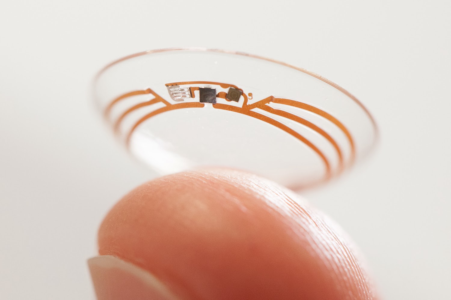

A U.S. patent was awarded a month ago for a contact lens having an integrated glucose sensor to the University of Washington through its Center for Commercialization (Seattle, WA). Last week, one of the inventors, Brian Otis, joined a Google researcher in disclosing their joint development of the invention through Google X, a stealth R&D group that made big headlines with its project to develop glasses that can search the Internet.
The post on the Google "Official Blog" stated: "We're now testing a smart contact lens that's built to measure glucose levels in tears using a tiny wireless chip and miniaturized glucose sensor that are embedded between two layers of soft contact lens material. We're testing prototypes that can generate a reading once per second."
The post is co-authored by Babak Parviz, creator of Google Glass and an affiliate professor in the department of electrical engineering at the University of Washington. Otis is an associate professor at the University of Washington Department of Electrical Engineering. Otis specializes in wireless biosensors.
"We're also investigating the potential for this to serve as an early warning for the wearer, so we're exploring integrating tiny LED lights that could light up to indicate that glucose levels have crossed above or below certain thresholds. It's still early days for this technology, but we've completed multiple clinical research studies which are helping to refine our prototype."

The patent describes significant involvement of plastics. In one iteration, a plastic substrate is coated with immobilizing materials such as polymethylmethacrylate (PMMA) or polydimethyl siloxane (PDMS). An immobilizing material is used to provide resistance to chemicals used in semiconductor manufacturing processes. A photovoltaic component which provides power is encapsulated in polymers such as parylene.
"Contact lenses and polymer test templates with metal interconnects and pads for solar cells were fabricated on optically transparent wafers of polyethylene terephthalate (PET)", according to the patent.
Plastic discs with assembled cells were molded into contact lenses at 392ºF on an aluminum mold.
Fabrication of an electrochemical sensor begins with transparent polyethylene terephthalate (PET) polymer film (100 micrometers thickness).
