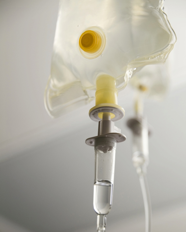

In order to establish a strategy for reducing the chemical footprint of plastics, Clean Production Action has published the Plastics Scorecard report, as noted in PlasticsToday: "The Plastics Scorecard gives one of the world's most valuable materials a bad grade" and "Plastics Scorecard measures chemical footprint of PVC/DEHP-based medical IV bags." In the report, an intravenous (IV) bag made from DEHP-plasticized PVC is compared with a polyolefin-based bag manufactured with layers of polyethylene and polypropylene. The report favors the polyolefin bag.
