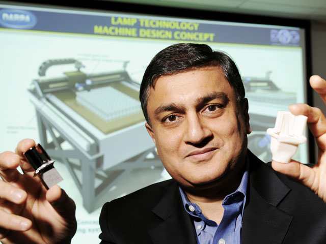

Suman Das, a professor at Georgia Tech's School of Mechanical Engineering, displays a ceramic mold produced directly from digital designs using large area maskless photopolymerization (LAMP) technology. In his right hand, he holds a single-crystal superalloy turbine airfoil that was cast using a ceramic mold of the kind he holds in his left hand. |
A collection of molds made through large area maskless photopolymerization (LAMP) technology and airfoil components produced using them. |
