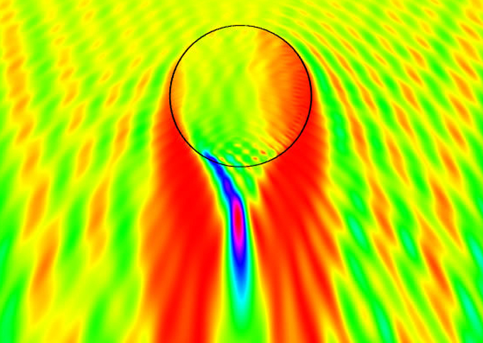

A spherical nanorobot made of silica focuses light like a near-field lens to write surface patterns for nanoscale devices. The red and purple areas indicate where the light is being magnified to produce a trench pattern on light-sensitive material. Image courtesy Laboratory for Nanobioelectronics, UC San Diego Jacobs School of Engineering.

The team developed two types of nanorobots: a spherical nanorobot made of silica focuses the light like a near-field lens while a rod-shaped version made of metal blocks the light. Each one is self-propelled by the catalytic decomposition of a hydrogen peroxide fuel solution. Two types of features are generated: trenches and ridges. When the photoresist surface is exposed to UV light, the spherical nanorobot harnesses and magnifies the light, moving along to create a trench pattern, while the rod-shape nanorobot blocks the light to build a ridge pattern.
