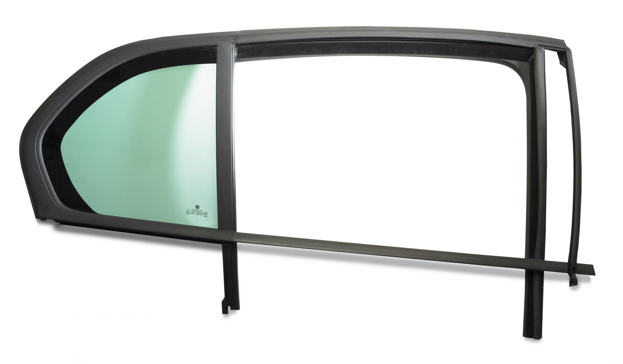

TPE-S being considered as encapsulamt material for rear side windows. |
