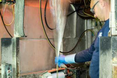

Waste glass melts at lower temperatures than the raw materials used in manufacturing glass fibers. It therefore makes it possible to save energy and thus lower CO2 emissions. Image courtesy of Lanxess.
