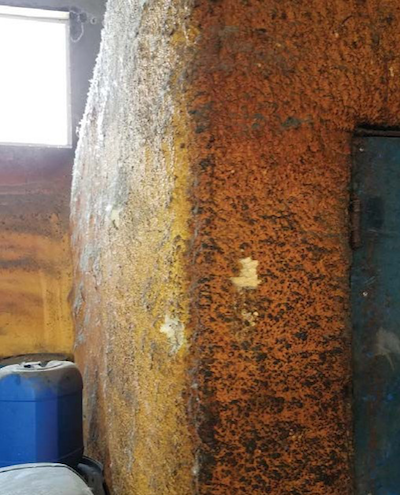

Wall containing foam produced in Dacheng Desheng Chemical Co., Ltd, holes poked to showcase strength of foam by factory representative.
