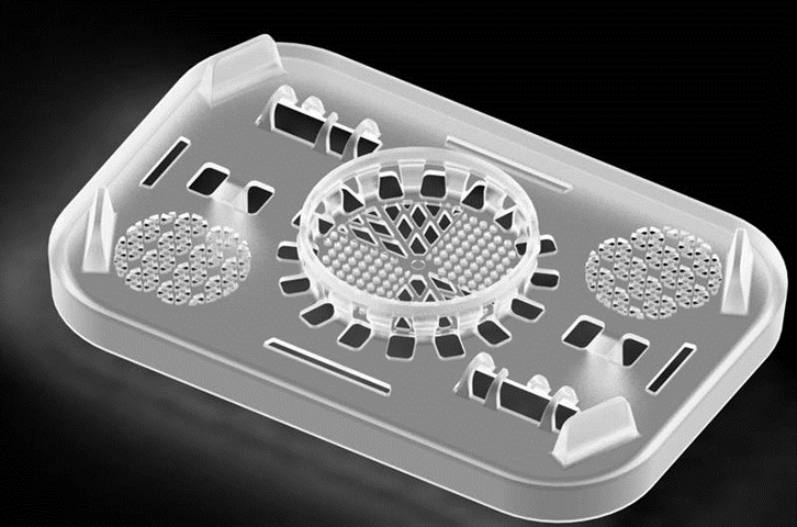

A specimen tray has complex geometry and design details, thin walls and by-passable shut-offs. A single, center gate provides excellent flow for repeatable fill quality, according to Kelly.
