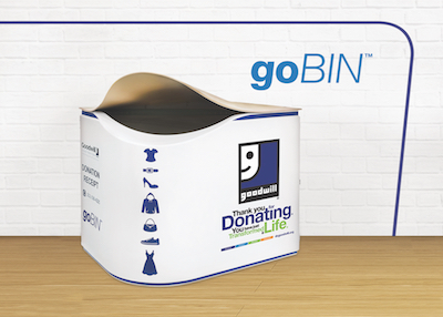

Earlier this year, Ray Products (Ontario, CA) had the opportunity to work with Goodwill to manufacture its brand new GoBINs. GoBINs are small-scale donation bins designed for lobbies of apartment buildings and office complexes. They make it easy for residents to donate to Goodwill, especially in high-density urban environments where many people don’t have cars.

GoBINs are about the size of a desk—around 4 1/4 feet long by 3 feet high and a bit over 3 feet deep. In terms of quantity, Goodwill wanted to scale manufacturing to meet demand as the program expands to cities around the country. Each individual batch could range from fewer than one hundred units to the low thousands.

Goodwill was also concerned about aesthetics. It wanted a bin that wouldn’t look out of place in a beautiful apartment building’s lobby. Choosing thermoforming allowed GoBINs to be molded in a high-gloss, custom color, and eliminated the need for paint. As a result, Goodwill was able to create a beautiful final product, while saving significantly on finishing costs.
