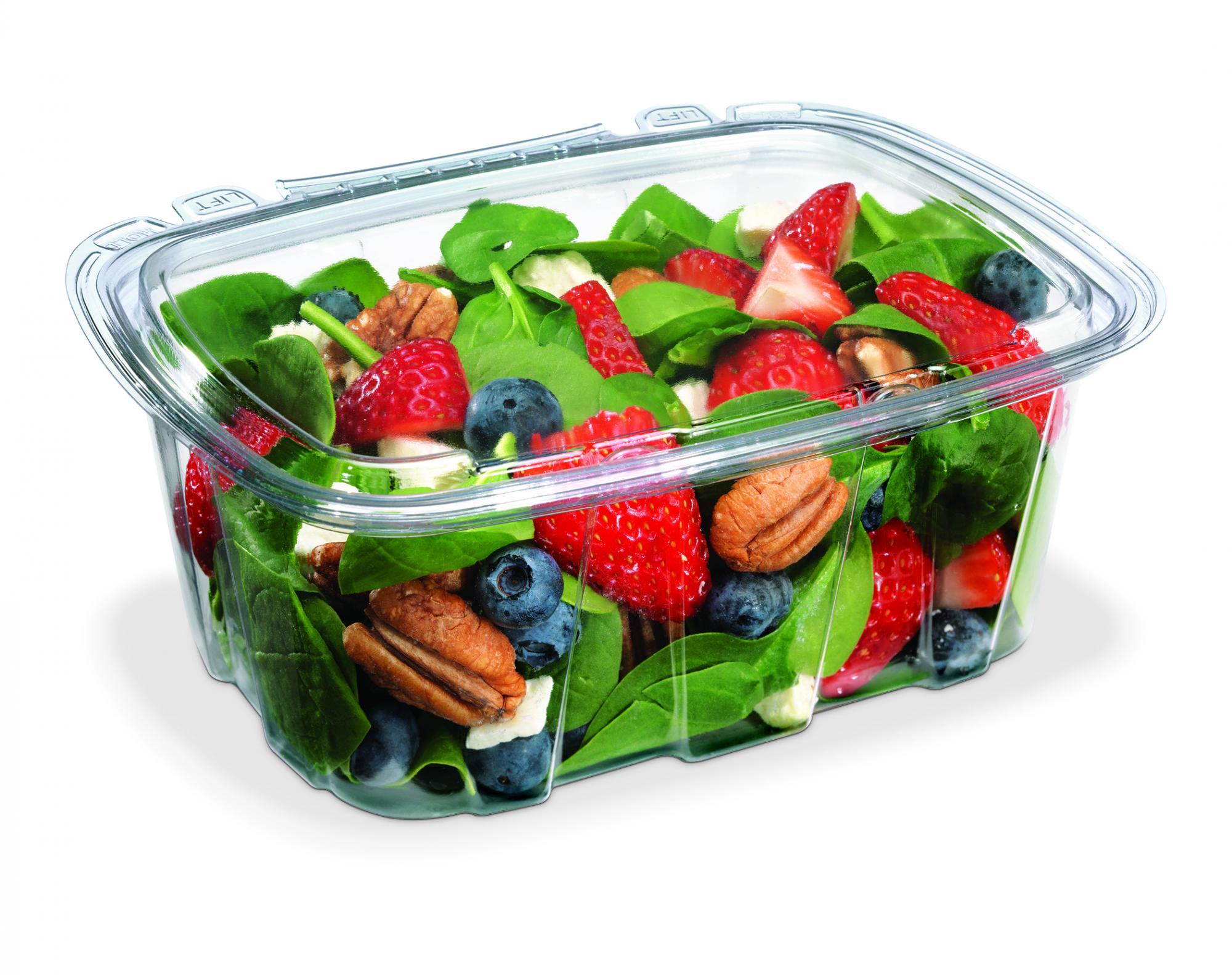

The food containers feature no removable byproducts or tear-away pieces, which the company said not only minimizes potential choking hazards; but the double-hinged tamper-evident design also eliminates the necessity for shrink bands or tamper-evident labels. The plastic packaging's offset, recessed cavity instructional tabs ensure easy gripping and opening while the leak-resistant design ensures no messes or spills either in store aisles or while on the go.
Don McCumber, principal product designer for Placon, told PlasticsToday that building the tamper-evident feature began with a highly developed manufacturing process. Placon engineered proprietary tooling specifically for this application and for each size.
"The tamper-evident feature consists of two perforations," he said. "Both have been precisely developed so that upon opening, the breakaway perforation separates from the clamshell, while the permanent hinge remains intact, but now in an upright position as a visual alert of having been tampered with. A patent-pending feature of the product helps in aligning the lid to the base when closing the lid which also helps the container, when closed, resist tampering."
