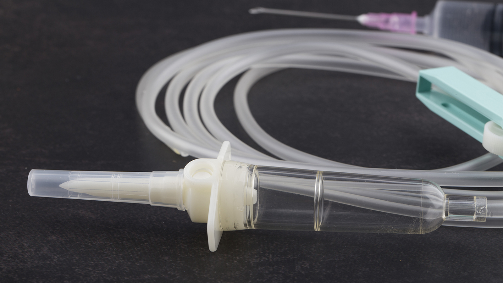

World’s first solvent-bondable TPE tubing
TekniPlex Healthcare also used the MD&M stage to highlight its range of solvent-bondable thermoplastic elastomer (TPE) tubing, an alternative to PVC produced with the company’s proprietary compound formulations.
PVC has been a mainstay tubing material for a number of reasons, explained Qualters, specifically because of its kink resistance and high-strength solvent-bonding capability. “Solvent bonding is critical to prevent leaks when you add cannulas and flow control valves to a tubing line, for example,” said Qualters. TPE is preferred for some procedures and applications, he added, but historically it has not been solvent bondable. Instead, barb connectors have been used and they are more susceptible to leaking. “With our material science capabilities, we developed the world’s first solvent-bondable TPE formulation, which provides solvent bonding strength similar to PVC along with kink resistance,” said Qualters.
