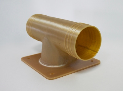

3D printed environmental control system duct adapter designed to cool aircraft whilst on the ground. 3D printed in Stratasys Nylon 12 on the Fortus 450mc (Photo: Business Wire) |

The company is also utilizing its Fortus 450mc 3D printer, purchased from Stratasys UK to build final parts on the ground. Marshall recently created a ducting adapter prototype for vital ground-running equipment – essential for providing fresh air to cool the aircraft’s avionics. 3D printing this particular part helped Marshall transition from typically costly aluminum processes.
“Before committing to expensive aluminum machining, we used the Fortus 450mc to 3D print a prototype in ASA [acrylonitrile styrene acrylate] material,” says Botting. “It enabled us to create an accurate working prototype of a complex component. We were then able to demonstrate it had the potential to be 3D-printed in Nylon [polyamide] 12 material as opposed to the more conventional method of machining from aluminum. The 3D-printed duct led to a significant cost reduction compared to machining the part out of aluminum, as well as a 63% reduction in overall weight.”
