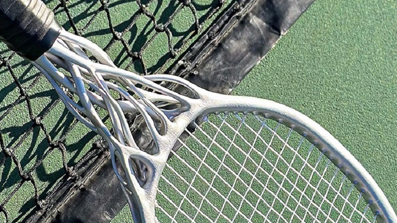

At first, Protolabs and All Design Lab wanted to show that you could make a tennis racket with 3D-printed metal. Once the object emerged the creators began to think they may have taken the traditional racket into the future.
Design and branding studio, All Design Lab partnered with Protolabs to manufacture Hìtëkw, a custom-designed tennis racket concept. The racket’s frame was conceptualized to break the mold of traditional tennis racket design by using direct metal laser sintering (DMLS) 3D printing.

Aside from aesthetics, practicality had to come into play for the concept. After all, someone would have to be able to easily hold and play with the tennis racket. The sheer concept and design of Hìtëkw was garnering a lot of media interest, so Lim and Lopez decided to turn to 3D printing to bring it into reality. “Our vision for the Hìtëkw tennis racket is to demonstrate how stepping beyond traditional boundaries can lead to innovative design,” said Lim. “We believe that challenging the usual limits of creativity makes it possible to explore new and exciting possibilities.”
As the idea developed, it became clear to Lim and Lopez that it would be nearly impossible to bring Hìtëkw to life via CNC machining or injection molding, due to the design’s intricate and complex nature. Protolabs’ metal 3D printing service became the clear technology of choice best suited to bring its organic geometry to life.
Hìtëkw’s 2024 Heads Out for a World Tour
With a height of more than 26 inches, the Hìtëkw is on the larger end for a DMLS-printed part. To produce it, Protolabs utilized two GE Additive X Line printers capable of producing metal parts at a large scale in either aluminum in Inconel. The All Design Lab team opted for lightweight aluminum to get a similar feel to today’s standard tennis racket.
