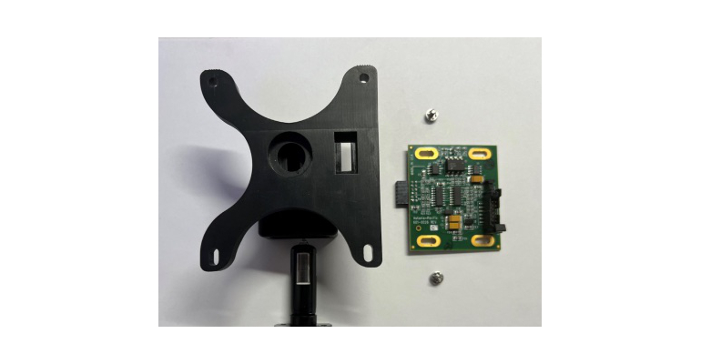

Carbon's 3D printing platform was used to produce an enclosure for a neonatal blood analyzer.Image courtesy of Carbon

However, due to a $50 part—a critical enclosure containing a very sensitive photomultiplier tube charged to 1000 V and a 5-V control board—fluorometer module production came to a standstill. The part had been in production for eight years, Menzel explained, but over the last two years, the company lost three of its legacy sheet metal vendors. And so, with no traditional manufacturing available within the three-to-four-month window for product delivery, Menzel said, Astoria had to look elsewhere to make this part.
The enclosure must adhere to demanding specifications and regulations, so the manufacturing task was highly constrained. The finished analyzer had to be high-pot, ground bond tested and meet ISO 13485, CE mark, IEC 61010, and UL 94 V-0 standards. It also had to be a light-absorbing deep black color to minimize stray light and aid in the detection of low-level fluorescence in the blood sample. Additionally, because it is an electrical housing, IEC-61010 requires Astoria-Pacific to conform with UL guidelines for flammability, “but it’s also being used in a clinical chemistry atmosphere, so it also has to be chemical resistant,” Menzel said.
