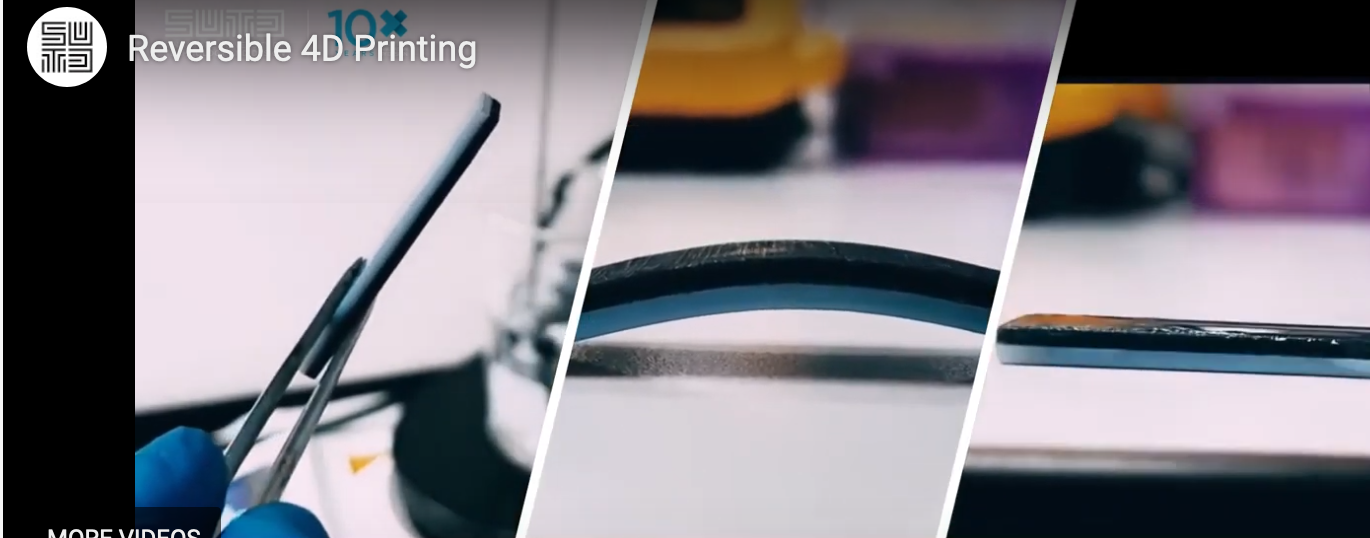

A team at Singapore University of Technology and Design (SUTD), has created a new reversible 4D printing technology that not only allows a 3D-printed object change shape either in response to heat or water, but also to revert back to its original shape without human intervention. (Image source: SUTD)
A team at Singapore University of Technology and Design (SUTD) has gone even a step further and created a new reversible 4D printing technology. In this new process, not only can a 3D-printed object change shape either in response to heat or water, it can also revert back to its original shape without human intervention.

Instead of using a hydrogel, the SUTD team used two materials compatible for printing in a 3D polyjet printer that demonstrated an ability to maintain their mechanical strength during and after the process—the transition material VeroWhitePlus and the elastomer TangoBlackPlus.
In the process, researchers used ethanol to cause the elastomer to swell, which—like the hydrogel in other similar processes—creates stress on the transition material, they said. Then, when heated, the transition material changes its shape to a second shape.
The process than requires drying the ethanol out of the elastomer and heating the transition material again, which allows it to revert to its original shape, researchers said. At the same time, the elastomer pulls the transition material back due to elastic energy stored in it after drying.
