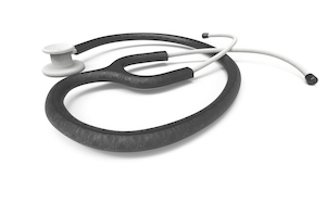

Product developers can leverage PolyJet to create 3D-printed parts comprised of both elastomeric and rigid materials. It complements overmolding, which the company added to its portfolio of services last year. Right now, PolyJet parts can be printed in black, white and clear materials, but colors will soon be available, noted Utley. The material selection includes multiple Shore A hardnesses of tear-resistant Agilus 30 for increased durability. PolyJet parts exhibit a smooth surface finish and can support complex geometries with flexible features, according to Proto Labs.
Like other 3D printing processes, PolyJet builds parts layer-by-layer. The machine jets out droplets of liquid photopolymers onto the build platform where they are immediately UV cured. Once the build is complete, support structures are removed, and the parts are ready without the need for additional finishing.
