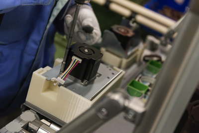

Assembling an electronic component using a 3D printed fixture produced in anti-static ABS plastic on the Stratasys Fortus 900mc Production 3D Printer improves manufacturing efficiency (Photo: Ricoh)
Ricoh's 3D printed jigs and fixtures boost assembly line productivity. These manufacturing aids were produced on the Stratasys Fortus 900mc Production 3D Printer using ABS plastic (Photo: Ricoh)
By producing the tools in durable acrylonitrile-butadiene-styrene (ABS) thermoplastic resin on a Stratasys Fortus 900mc Production 3D Printer, Ricoh is able to customize each tool precisely according to the part geometry while reducing the tool’s weight. This has enabled Ricoh to accelerate the manufacturing process in which an operator typically handles more than 200 different part types each day.
