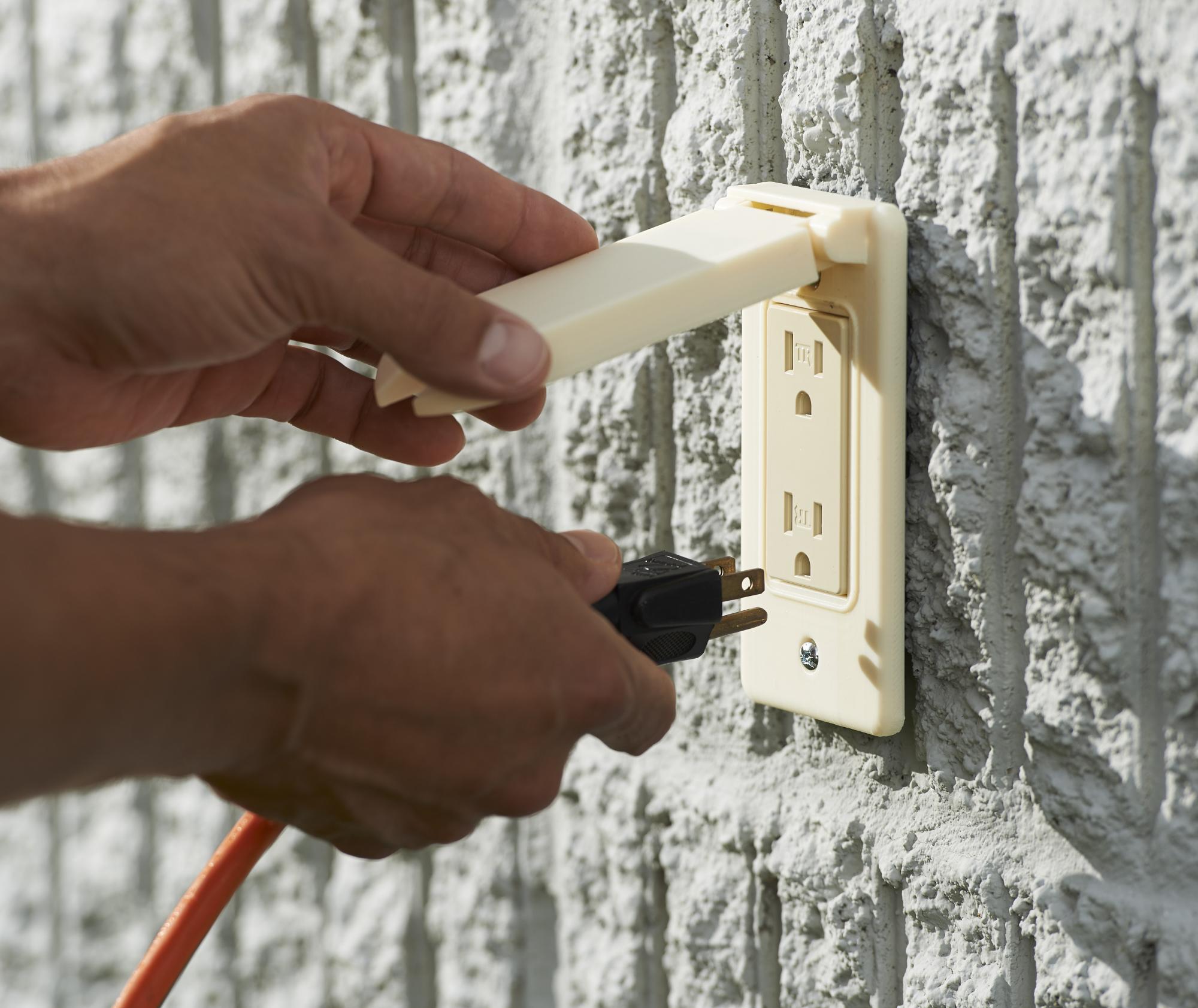

ASA, Stratasys' new thermoplastic material is ideal for electrical boxes, electronics among other applications.

Additionally, Stratasys announced a new thermoplastic material option for its FDM (Fused Deposition Modeling)-based production 3D printers: ASA (Acrylonitrile Styrene Acrylate). ASA is an all-purpose material used for the production of prototypes, manufacturing tools, and finished goods. Manufacturers in the automotive, electronics, commercial, sporting goods, and construction industries can benefit from ASA's UV stability, strength, and durability, according to Stratasys.
Compatible with the Fortus 360mc, 400mc, and 900mc 3D Production Systems, ASA thermoplastic surpasses the capabilities of ABS, offering UV resistance, so parts will resist fading and remain durable with long-term exposure to direct sunlight. ASA offers an exceptional surface finish and has the best aesthetics of any FDM material available. Compared to AS, details such as printed text and other features are greatly improved by ASA's matte finish, said Stratasys.
