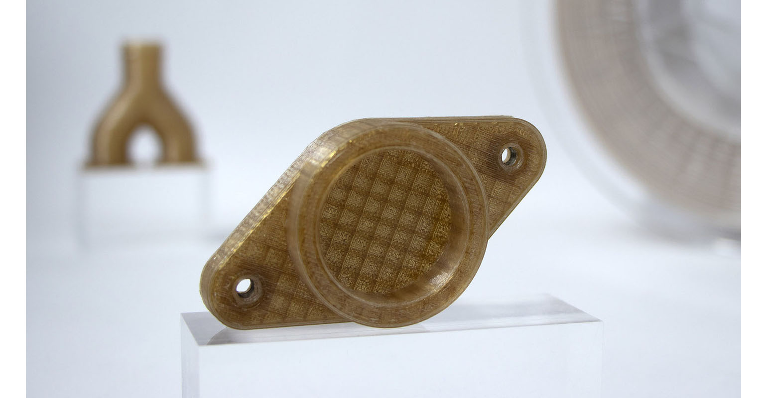

3D printed PAEK part

The new PAEK-based Victrex AM filament features excellent mechanical properties, which are in demand for high-performance parts. Repurposing injection molding PEEK into filament fusion AM typically results in weak parts because of poor interlayer bonding. The new material is designed to address this weakness. According to Intamsys, Victrex AM 200 filament has a higher Z-axis strength and has shown up to 80% strength in the X-Y direction with a better fused filament forming (FFF) printing adaptability than existing PAEK materials.
The new Victrex AM 200 filament exhibits better interlayer adhesion than other PAEK materials. Image courtesy Victrex.
Intamsys has conducted physical and mechanical performance tests on the new Victrex PAEK filament material using different printers, including its industrial-grade, high-temperature Funmat Pro 410. “Our test results to date have shown that the Victrex AM 200 filament has better interlayer adhesion than other PAEK materials on Intamsys machines,” said Charles Han, founder and CEO at Intamsys. “Compared with unfilled PEEK, it is designed with slower crystallization, a lower melt temperature, and a viscosity fine tuned to the filament fusion process, such as easier flow in the build chamber after leaving the nozzle. All this contributes to improved inter-laminar adhesion, easier printing (less shrinkage and warp), and a better suitability for FDM 3D printing compared to other similar options, based upon the testing we have done up to this point.”
