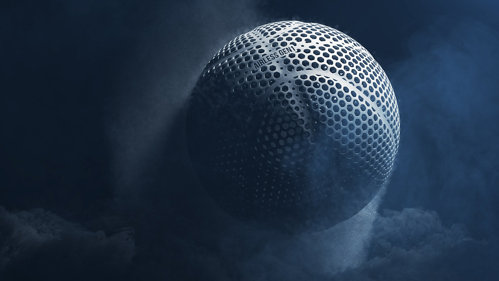

The Wilson Airless Gen1 reportedly comes very close to matching the performance specs of a regulation basketball, including its weight, size, and bounce.
The main updates to the Wilson Airless Gen1 since the prototype was developed include:
An improved lattice design for more consistent performance and bounce. The ball still has the same see-through lattice with eight panel-like "lobes,” adds Wilson.
Holes integrated within the channels to accelerate the manufacturing process, making it faster to create each ball.
A built-in label in each ball for customization with the exact, limited number in which it was produced.
In addition to the recognizable jet-black color of the prototype, the Airless Gen1 will also be available in brown and natural white.
Key partners in the project included General Lattice providing computational design services, DyeMansion supplying color and finishing solutions, EOS bringing technical oversight and a roadmap for mass production, and SNL Creative, the primary manufacturing hub for this first launch.
While it’s an interesting technical achievement — and a marketing slam dunk, clearly, since we’re talking about it — the practical effect will be limited, according to 3D-printing authority and business consultancy Wohlers Associates. “The balls are made using polymer powder bed fusion (PBF) systems from EOS,” it writes. “While Wilson is to be commended for bringing this innovation to market, it is expected to have a limited practical effect. The ball will sell for $2,500, meaning that relatively few will be bought by well-heeled aficionados of the sport. The high cost is driven by the size of the ball, coupled with print speed. Also, few balls can be printed at one time.”
