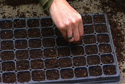

Seedling trays are one possible application for torrefied plastic composites.

Orts initial research aim was to use these inert fillers to reduce the density of the resulting plastic composite. Cryo-ground torrefied almond shell, typically with particle size of 150 µm, has a lower density than polyethylene and polypropylene (PP) after all. But the filler also proved to improve stiffness, raise the heat deflection temperature (HDT) by 5–8°C, and, to boot, realize a darker color in the final product, meaning the use of carbon black could be minimized or even eliminated. This elevated performance has been demonstrated in prototype products such as sheet that could potentially be applied in seedling trays for tomatoes. When stacked under harsh California temperatures, unreinforced trays molded from LDPE tended to warp. Not so with the filled version.
