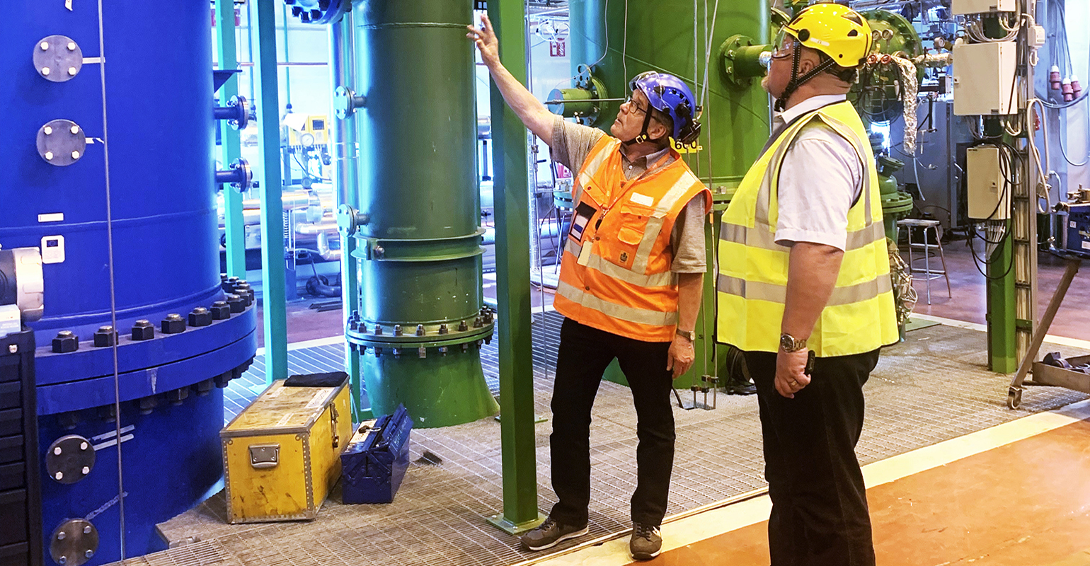

VTT pilot plant
Matti Nieminen and Timo Sokka at VTT Bioruukki pilot plant.Image courtesy of VTT
